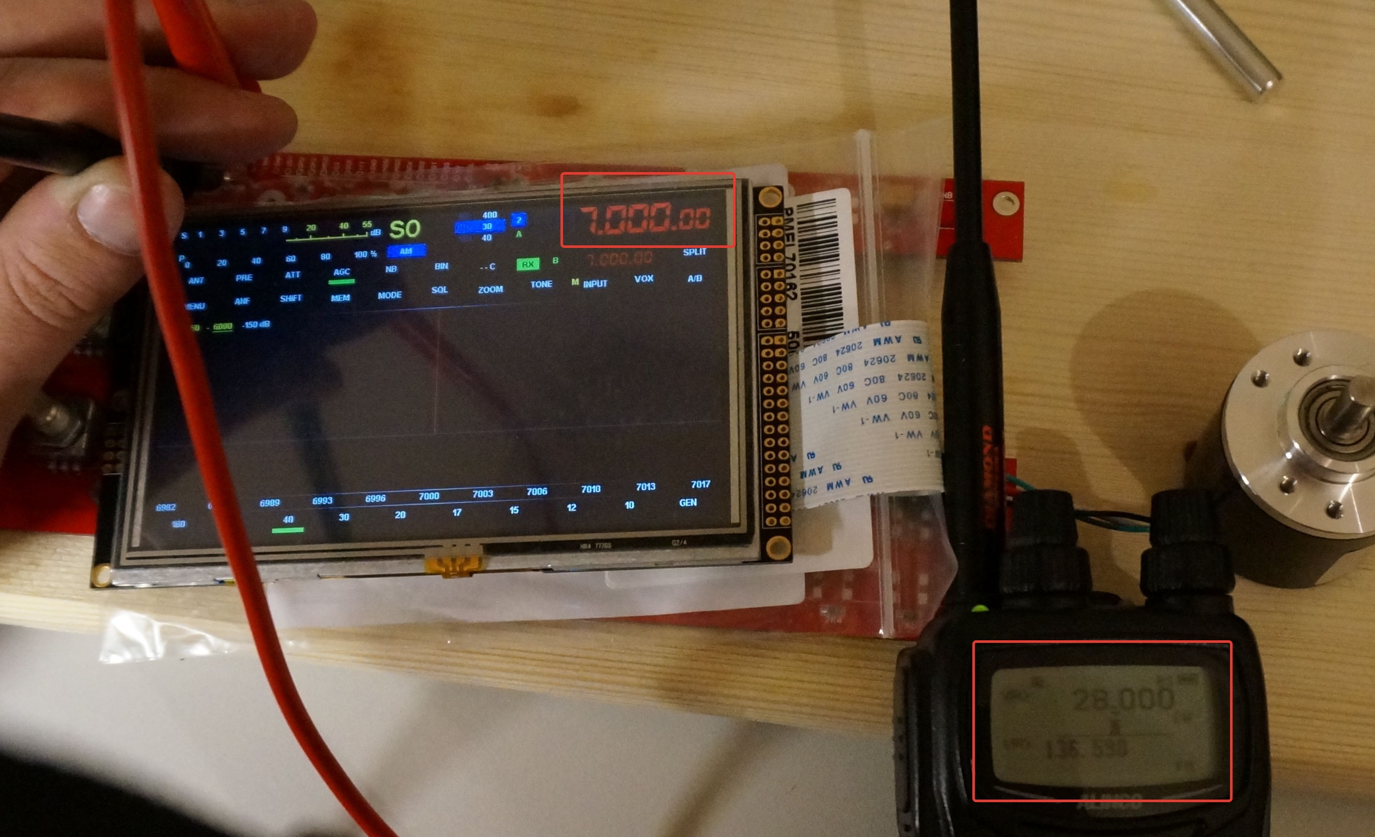

I should have known about multiply factor of 4 Smile
Have set 7Mhz and tuned to 28Mhz and heard tone! On 90Mhz very strong broadcast station working.
Thank you, Artur.

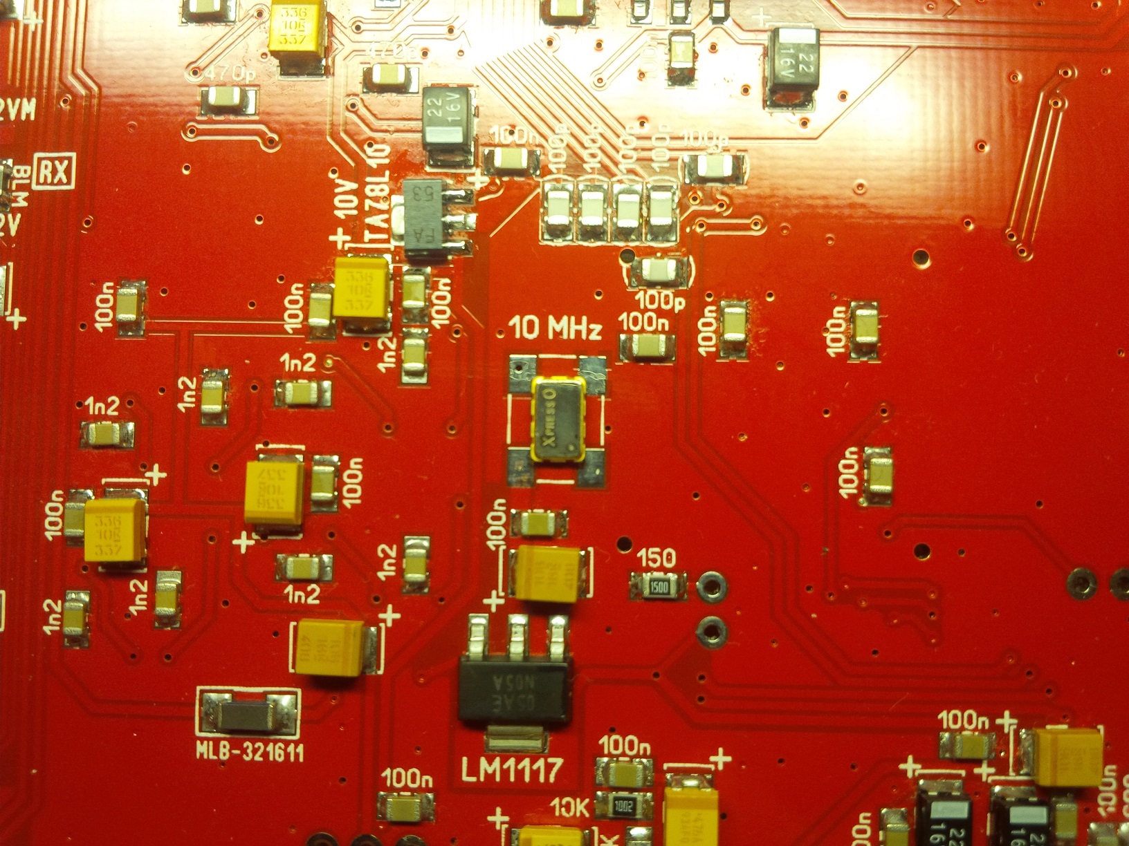

(09-01-2016 16:54)SP3OSJ napisał(a):  http://pl.aliexpress.com/item/Hot-Sale-S...38162.html
Hmmm... it's definitely not 5x3, but 7x5.
