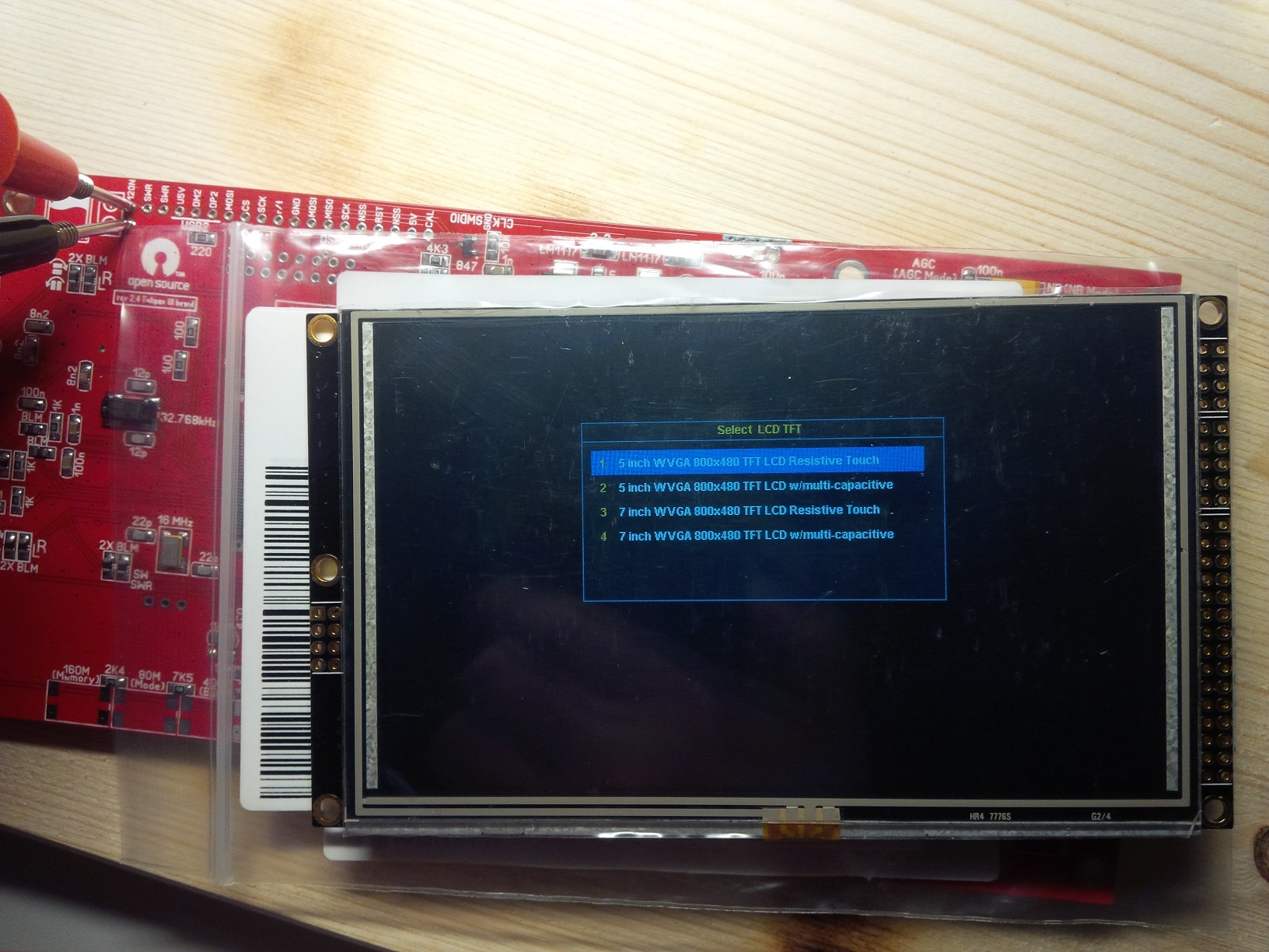

I have checked it not once, all clear (except 33 and 32 pins, but it should be).
I think STM is simply dead.
Could AD9952 affect STM work this way? It is under suspect too Smile
Well, things become stranger and stranger.
Flashed .hex from cqham, it loaded and displayed LCD selection menu.
But i can't select, STM dose not respond to encoder, but encoder is ok and all lines from encoder to STM ok too.
But i can press select knob, then we return to "test FSMC OK..." and stuck at it again or just turn on LCD back light.
Seems like STM really dead...
